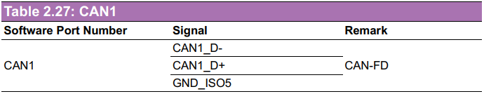

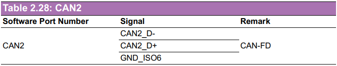

UIO-4035 CAN-FD:CAN1、CAN2
UIO-4035 both have two CAN ports (can1 & can2).​

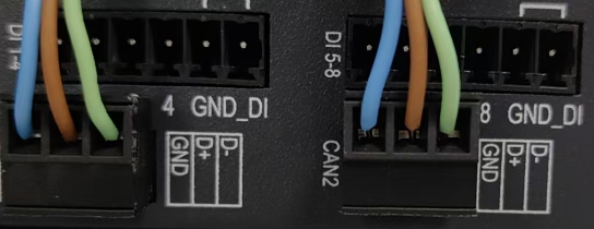

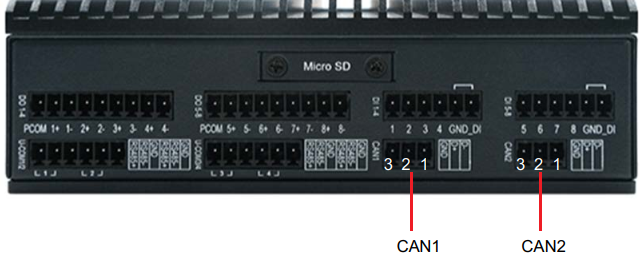

Mode of connection:
Send and Receive Data​
Taking can1 as receiver and can2 as sender:
